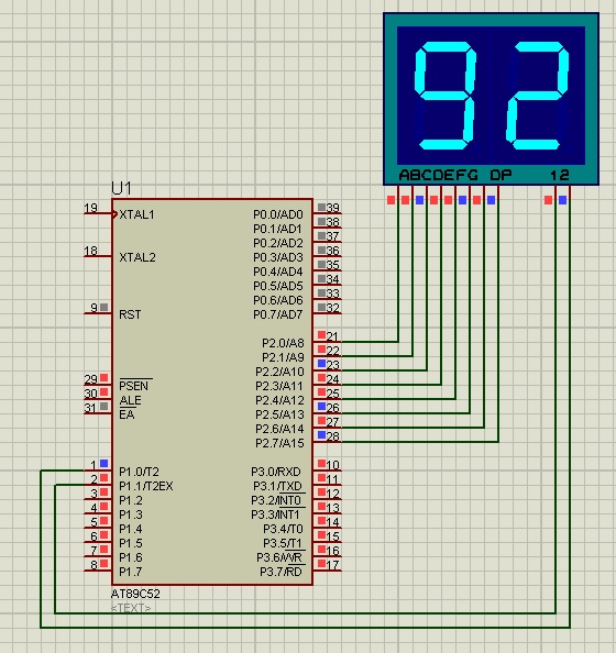

为什么实现不了单片机倒计时呢,是哪里错了,还是思路就错了吗?求指点
#include <reg52.h>
LED_[]={0x3f,0x06,0x5b,0x4f,0x66,0x6d,0x7d,0x07,0x7f,0x6f};
disbuf[]={0x01,0x02};
unsigned char m;
void delay(unsigned char time)
  unsigned char i;
  int j=0;
  for(i=time;i>0;i--)
   for(j=0;j<125;j++);
break_() interrupt 3
        delay(1);
        m=m-1;
void main()
        int j=0;
        TMOD=0x20;
        EA=1;
        ET1=1;
        TR1=1;
        TH1=0x1a;
        TL1=0x1a;
        m=99;
        if(j==0)
                P1=disbuf[j];
                P2=LED_[m%10];
                delay(10);
                j=1;
        else
                P1=disbuf[j];
                P2=LED_[m/10];
                delay(10);
                j=0;

1.位码错误     2.中断函数计数变量m计量单位只有250us,要换算成秒来显示。int j=0;数据类型使用的不恰当
  1. #include <reg52.h>
  2. LED_[]={0x3f,0x06,0x5b,0x4f,0x66,0x6d,0x7d,0x07,0x7f,0x6f};
  3. disbuf[]={0xfe,0xfd};
  4. char m;
  5. unsigned int n;
  6. void delay(unsigned char time)
  7. {
  8.         unsigned char i;
  9.         int j=0;
  10.         for(i=time;i>0;i--)
  11.                 for(j=0;j<125;j++);
  12. }
  13. break_() interrupt 3
  14. {
  15. //        delay(1);
  16.         n++;
  17.         if(n>=4000)
