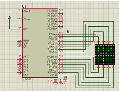

单片机8x8LED汉字显示 Proteus仿真程序
  1. #include <AT89X52.H>
  2. unsigned char code taba[]={0xfe,0xfd,0xfb,0xf7,0xef,0xdf,0xbf,0x7f};//行选
  3. unsigned char code tabb[]={0x08,0x49,0x49,0x7F,0x08,0x49,0x49,0x7F};//选列"出"
  4. unsigned char code tabc[]={0x00,0x02,0x04,0x08,0x18,0x24,0x42,0x81};//"入"
  5. unsigned char code tabd[]={0xFF,0x4A,0x2A,0x1C,0xFF,0x08,0x08,0x08};//"平"
  6. unsigned char code tabe[]={0x08,0xFF,0x89,0x04,0x7F,0x14,0x1C,0x63};//"安"
