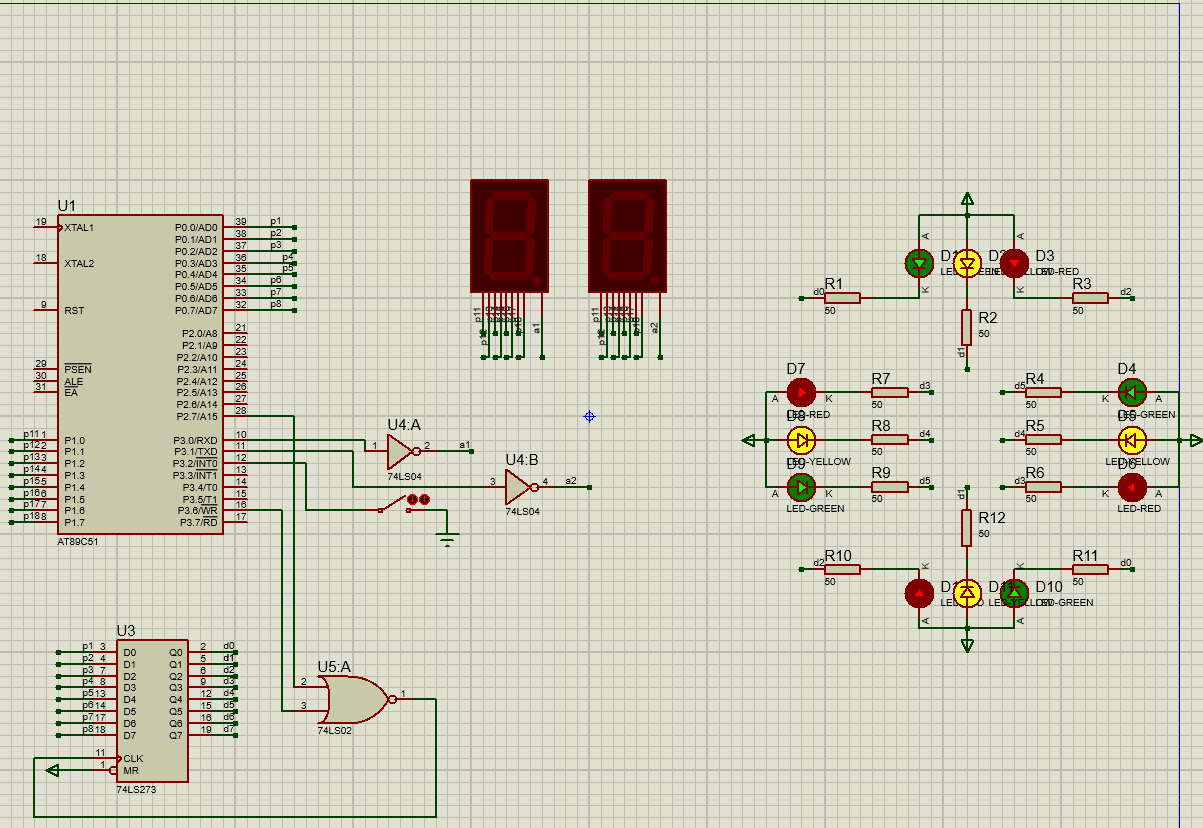

基于89C51的交通灯设计
#include<reg51.h>
#include <absacc.h>
#define PORT XBYTE   [0x7fff]
unsigned char code Tab[10]={0xc0,0xf9,0xa4,0xb0,0x99,0x92,0x82,0xf8,0x80,0x90}; //0~9段码
unsigned char cf[4]={1,2,3,4};
sbit sw=P3^0;//数码管动态显示的位选定义
sbit gw=P3^1;
void disp(unsigned char i)
        PORT=~i;
void delay(unsigned char j)           //0.01s*j
unsigned char m,n;
        for(;j>0;j--)
                  for(m=0;m<20;m++)
                   for(n=0;n<250;n++);
void bcdm(unsigned char q)  //数码管显示的十位和个位
        cf[0]=q/10;
        cf[1]=q%10;
void smgdjs(unsigned char q)  //数码管倒计时
        unsigned char a;
          while(q)
                bcdm(q);
                 for(a=0;a<50;a++)
                sw=0;gw=1;
                P1=Tab[cf[0]];
                delay(1);
                sw=1;gw=0;
                 P1=Tab[cf[1]];
                delay(1);
                q--;
void hds(void)   //黄灯闪烁
unsigned char k,a,l;
        for(k=5;k>0;k--)
         bcdm(k);
     disp(0x12);
          for(a=0;a<50;a++)
          sw=0;gw=1;
          P1=Tab[cf[0]];
          delay(1);
          sw=1;gw=0;
          P1=Tab[cf[1]];
          delay(1);
        disp(0x0);
        for(a=0;a<50;a++)
          sw=0;gw=1;
          P1=Tab[cf[0]];
          delay(1);
          sw=1;gw=0;
          P1=Tab[cf[1]];
          delay(1);
void main(void)
        unsigned char p;
        disp(0x21);
        delay(10);
                 disp(0x09);
                p=10;
                smgdjs(p);
                hds();
                disp(0x24);
                         smgdjs(p);
        //        delay(50);
                hds();
