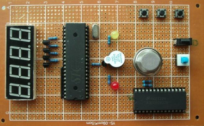

- #include <reg52.h>
- //宏定义
- #define uint unsigned int
- #define uchar unsigned char
- #define Data_ADC0809 P1
- //管脚声明
- sbit Feng = P3^0;
- //ADC0809
- sbit ST=P3^3;
- sbit EOC=P3^4;
- sbit OE=P3^2;
- //按键
- sbit Key1=P3^5;
- sbit Key2=P3^6;
- sbit Key3=P3^7;
- //显示数组 0-9+F
- uchar Data_[]={0x3f,0x06,0x5b,0x4f,0x66,0x6d,0x7d,0x07,0x7f,0x6f,0x71,0x3f};
- sbit Wei1 = P2^7;
- sbit Wei2 = P2^6;
- sbit Wei3 = P2^5;
- sbit Wei4 = P2^4;
- //函数声明
- extern uchar ADC0809();
- void Display(uchar X,uchar Data);
- void delay(uint t);
- //酒精含量变量
- uchar temp=0;
- //蜂鸣器变量
- uchar FF=10;
- //显示模式
- uchar Mode=0;
- uchar p;
- void main()
- while(1)
- //正常模式
- if(Mode==0)
- //读取AD值
- temp=ADC0809();
- for(p=0;p<30;p++)
- Display(0,temp);
- //判断是否报警
- if(temp>FF)
- Feng=0;
- else
- Feng=1;
- //调整模式
- else
- Display(1,FF);
- //功能键
- if(Key3==0)
- Feng=0;
- delay(100);
- while(Key3==0)
- if(Mode==0)
- Display(0,temp);
- else
- Display(1,FF);
- if(Mode==0)
- Mode=1;
- else
- Mode=0;
- Feng=1;
- //增加
- if(Key2==0&&Mode==1)
- Feng=0;
- delay(100);
- while(Key2==0)
- Display(1,FF);
- FF++;
- if(FF==251)
- FF=250;
- Feng=1;
- //减少
- if(Key1==0&&Mode==1)
- Feng=0;
- delay(100);
- while(Key1==0)
- Display(1,FF);
- FF--;
- if(FF==0xff)
- FF=0;
- Feng=1;
- //ADC0809读取信息
- uchar ADC0809()
- uchar temp_=0x00;
- //初始化高阻太
- OE=0;
- //转化初始化
- ST=0;
- //开始转换
- ST=1;
- ST=0;
- //外部中断等待AD转换结束
- while(EOC==0)
- //读取转换的AD值
- OE=1;
- temp_=Data_ADC0809;
- OE=0;
- return temp_;
- //延时
- uint i,j;
- for(i=0;i<t;i++)
- for(j=0;j<10;j++);
- //显示 X表示状态 Data表示数据
- Wei1=1;
- Wei2=1;
- Wei3=1;
- Wei4=1;
- P0=0xff;
- //正常模式
- if(X==0)
- P0=~Data_[11];
- //非正常
- else
- P0=~Data_[10];
- Wei1=0;
- Wei2=1;
- Wei3=1;
- Wei4=1;
- delay(10);
- Wei1=1;
- Wei2=1;
- Wei3=1;
- Wei4=1;
- P0=~Data_[Data/100];
- Wei1=1;
- Wei2=0;
- Wei3=1;
- Wei4=1;
- delay(10);
- Wei1=1;
- Wei2=1;
- Wei3=1;
- Wei4=1;
- P0=~Data_[Data/10%10];
- Wei1=1;
- Wei2=1;
- Wei3=0;
- Wei4=1;
- delay(10);
- Wei1=1;
- Wei2=1;
- Wei3=1;
- Wei4=1;
- P0=~Data_[Data%10];
- Wei1=1;
- Wei2=1;
- Wei3=1;
- Wei4=0;
- delay(10);
- Wei1=1;
- Wei2=1;
- Wei3=1;
- Wei4=1;
