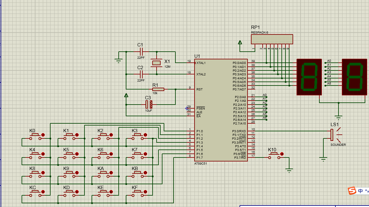

需要一份详细的程序解释
100黑币
#include <reg52.h>
#define uchar unsigned char
#define uint unsigned int
sbit BEEP = P3^0;
sbit K1 = P3^7;
uchar code DSY_CODE[]=
        0xc0,0xf9,0xa4,0xb0,0x99,0x92,0x82,0xf8,0x80,0x90,0x88,0x80,0xc6,0xc0,0x86,0x8e
uchar Pre_KeyNO = 16,KeyNO = 16;
void DelayMS(uint ms)//延时函数
        uchar t;
        while(ms--)
                 for(t=0;t<120;t++);
void Keys_Scan()
        uchar Tmp;
        P1 = 0x0f;
        DelayMS(1); //利用短延时来消抖
        Tmp = P1 ^ 0x0f;
        switch(Tmp)
                 case 1: KeyNO = 0; break;//列检测
                case 2: KeyNO = 1; break;
                case 4: KeyNO = 2; break;
                case 8: KeyNO = 3; break;
                default: KeyNO = 16;
        P1 = 0xf0;
        DelayMS(1);
        Tmp = P1 >> 4 ^ 0x0f;//向后移4位,求出P1的值
        switch(Tmp)
                 case 1: KeyNO += 0; break;//行检测
                case 2: KeyNO += 4; break;
                case 4: KeyNO += 8; break;
                case 8: KeyNO += 12;
void Beep()
        uchar i;
        for(i=0;i<50;i++)
                 DelayMS(1);
                BEEP = ~BEEP;
        BEEP = 0;
void main()
        P0 = 0x00;
        P2 = 0x00;
                 P1 = 0xf0;
                if(P1 != 0xf0)
                   Keys_Scan();
                        P0 = 0x3f;//0
                        P2 = ~DSY_CODE[KeyNO];//0~f
                        Beep();
                        DelayMS(100);
                if(K1==0)
                     while(K1==0);
                       P1 = 0xf0;
                       if(P1 != 0xf0)
                       if(KeyNO<10)
                          Keys_Scan();
                          P0 = 0x3f;
                          Beep();
                          DelayMS(100);
                       else
                          Keys_Scan();
                          P0 = 0x06;//1
                          P2 = ~DSY_CODE[KeyNO-10];//0~6
                          Beep();
                          DelayMS(100);
                       if(K1==0)
                          while(K1==0);
                             break;
