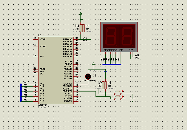

中断的应用
#include<reg51.h>
#define uchar unsigned char
#define uint unsigned int
uchar code tab[10]={
0x3f,0x06,0x5b,0x4f,0x66,
0x6d,0x7d,0x07,0x7f,0x6f};
uint c=0,e=0,w=10,q=1,p=0;
sbit led=P3^0;
void doudelay(uint i)
        uint j;
        while(--i)
        for(j=0;j<120;j++)
void xianshi()
        led=q%2;
        P0=0xfe;
        P1=tab[c/10];
        doudelay(20);
        P0=0xfd;
        P1=tab[c%10];
        doudelay(20);
void xianshi1()
        led=q%2;
        P0=0xfe;
        P1=tab[c/10];
        doudelay(10);
        P0=0xfd;
        P1=tab[c%10];
        doudelay(10);
void main()
        P1=0x00;
        IE=0x85;
        TCON=0x00;
        IP=0x04;
                xianshi();
void int0() interrupt 0
        doudelay(1);
        while(e<99)
                 c=e;
                c++;
                 e=c;
                xianshi();
                doudelay(15);
        c=0;
        e=0;
void int1() interrupt 2
        EA=0;
        doudelay(1);
        while(w<=20)
                while(p<10)
                        p++;
                        xianshi1();
                p=0;
                q++;
                w++;
        w=0;
        q=1;
        EA=1;
