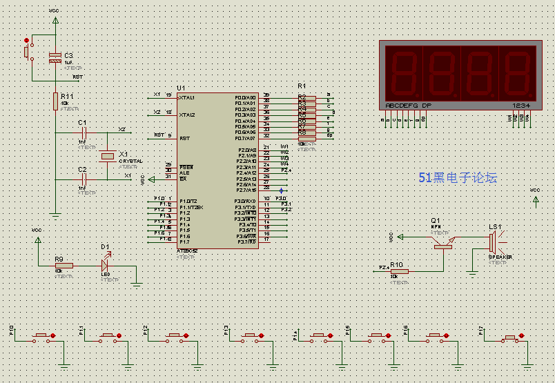

作为保存吧
- #include "stc15f2k60s2.h" //调系统头文件
- #define Display P0 //定义数码管显示端
- #define Speak P24 //定义蜂鸣器接口
- #define uint unsigned int
- #define uchar unsigned char
- unsigned char sth,stl; //定义全局变量 sth stl
- unsigned int i,j; //定义循环变量i j
- unsigned char code table[]={0x3f,0x06,0x5b,0x4f,0x66,0x6d,0x7d,0x07,0x7f,0x6f};//定义数码管显示 0-9,A-F
- unsigned char code Music_Code[]={ //八个音符 do re mi fa so la si 高音do
- 0xf8,0x8b,0xf9,0x5b,0xfa,0x14,0xfa,0x66,
- 0xfb,0x03,0xfb,0x8f,0xfc,0x0b,0xfd,0xee};

- void main() //主函数入口
- Time0_Init(); //定时器T0初始化
- P2=0x00;
- Speak=1; //蜂鸣器端口置1 停止工作。
- while(1) //无限循环
- switch(P1) //switch语句判断检测 P1按键状态

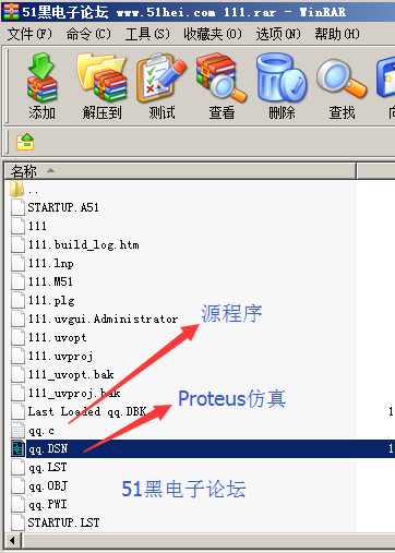

所有资料51hei提供下载:
111.rar
(71.71 KB, 下载次数: 96)
