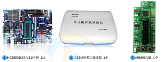

  • Hardware platform:
  •    PRECHIN microcontroller development toolkit as shown below, including the main board (HC6800EM3-V3.0) and other accessories:

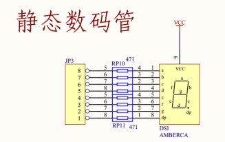

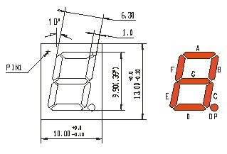

  •    Seven-segment display (SSD)
The SSD used in the experimental toolkit adopts common anode configuration with the circuit shown below.

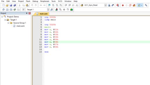

  •    Write a program to display your own student matriculation number on the seven-segment display (SSD) sequentially.

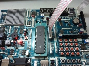

Reference steps:
  •    Connect the SSD (JP3) with port 0 (P0) with wires as shown in the following figure
  •    Create a project in Keil uvision IDE
  •    Add the assembly code “DataMoving.asm” into the project
  •    Write the program in the section shown in the following figure
  •    Store your student matriculation number in RAM address starting from 40H using immediate addressing mode.
  •    Copy each digit of the matriculation number stored in RAM using register indirect addressing mode to register A.
  •    Fetch the corresponding hexadecimal encoding stored in ROM using register indexed addressing mode and store it in register A.
  •    Copy the fetched hexadecimal encoding to port 0 (P0).
  •    After copying a number to P0, add an instruction “AJMP DELAY” below to pause for a moment so that we can check the result on SSD clearly.

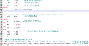

  1.         ORG         0000H            ;程序从此地址开始运行
  2.         LJMP         MAIN            ;跳转到 MAIN 程序处
  3.         ORG         030H            ;MAIN 从030H处开始
  4. MAIN:
  5. ;*************Add your code below*************************************
  6.         MOV                40H,#02H
  7.         MOV                41H,#00H
  8.         MOV                42H,#01H
  9.         MOV                43H,#06H
  10.         MOV                44H,#01H
  11.         MOV                45H,#04H
  12.         MOV                46H,#01H
  13.         MOV                47H,#04H
  14.         MOV                48H,#01H
  15.         MOV                49H,#01H
  16.         MOV                4AH,#02H
  17.         MOV                4BH,#02H
  18.         MOV                4CH,#02H        ;在40H-4CH里面存入2016141411222学号
  19.         MOV                DPTR,#TAB
  20.         MOV                R0,#40H                ;R0=40H
  21.         MOV                A,@R0                ;A=02H
  22.         MOVC        A,@A+DPTR        ;A=0A4H
  23.         MOV                P0,A                ;2
  24.         INC                R0                        ;R0=41H
  25.         LCALL        DELAY                ;延时
  26.         MOV                A,@R0                ;A=00H
  27.         MOVC        A,@A+DPTR        ;A=0C0H
  28.         MOV                P0,A                ;0
  29.         INC                R0                        ;R0=42H
  30.         LCALL        DELAY
  31.         MOV                A,@R0                ;A=01H

  85. ;*********************************************************************
  86.         AJMP         MAIN        ;跳转到主程序处
  87. DELAY:
  88.         MOV         R5,#04H           ;将立即数传给寄存器R5
  89. F3:
  90.         MOV         R6,#0FFH
  91. F2:
  92.         MOV         R7,#0FFH
  93. F1:
  94.         DJNZ         R7,F1               ;若为0程序向下执行,若不为0程序跳转到
  95.         DJNZ         R6,F2
  96.         DJNZ         R5,F3
  97.         RET
  98. ;七段数码显管显示数字编码(对应0~F)
  99. ;TAB: DB 3Fh,06h,5Bh,4Fh,66h,6Dh,7Dh,07h,7Fh,6Fh,77h,7Ch,39h,5Eh,79h,71h                 ;共阴极七段数码显管
  100. TAB: DB 0C0h,0F9h,0A4h,0B0h,99h,92h,82h,0F8h,80h,90h,88h,83h,0C6h,0A1h,86h,8Eh         ;共阳极七段数码显管
  101.         END

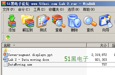

所有资料51hei提供下载:
Lab 2.rar (1.88 MB, 下载次数: 4)
