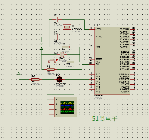

- ORG 0000H
- LJMP MAIN
- ORG 000BH
- LJMP T0INT
- ORG 0030H
- MAIN:MOV TMOD,#01H
- MOV TH0,#0ECH
- MOV TL0,#78H
- SETB EA
- SETB ET0
- SETB TR0
- HERE:SJMP HERE
- ORG 0100H
- T0INT:MOV TH0,#0ECH
- MOV TL0,#78H
- CPL P1.2
- RETI
- END
