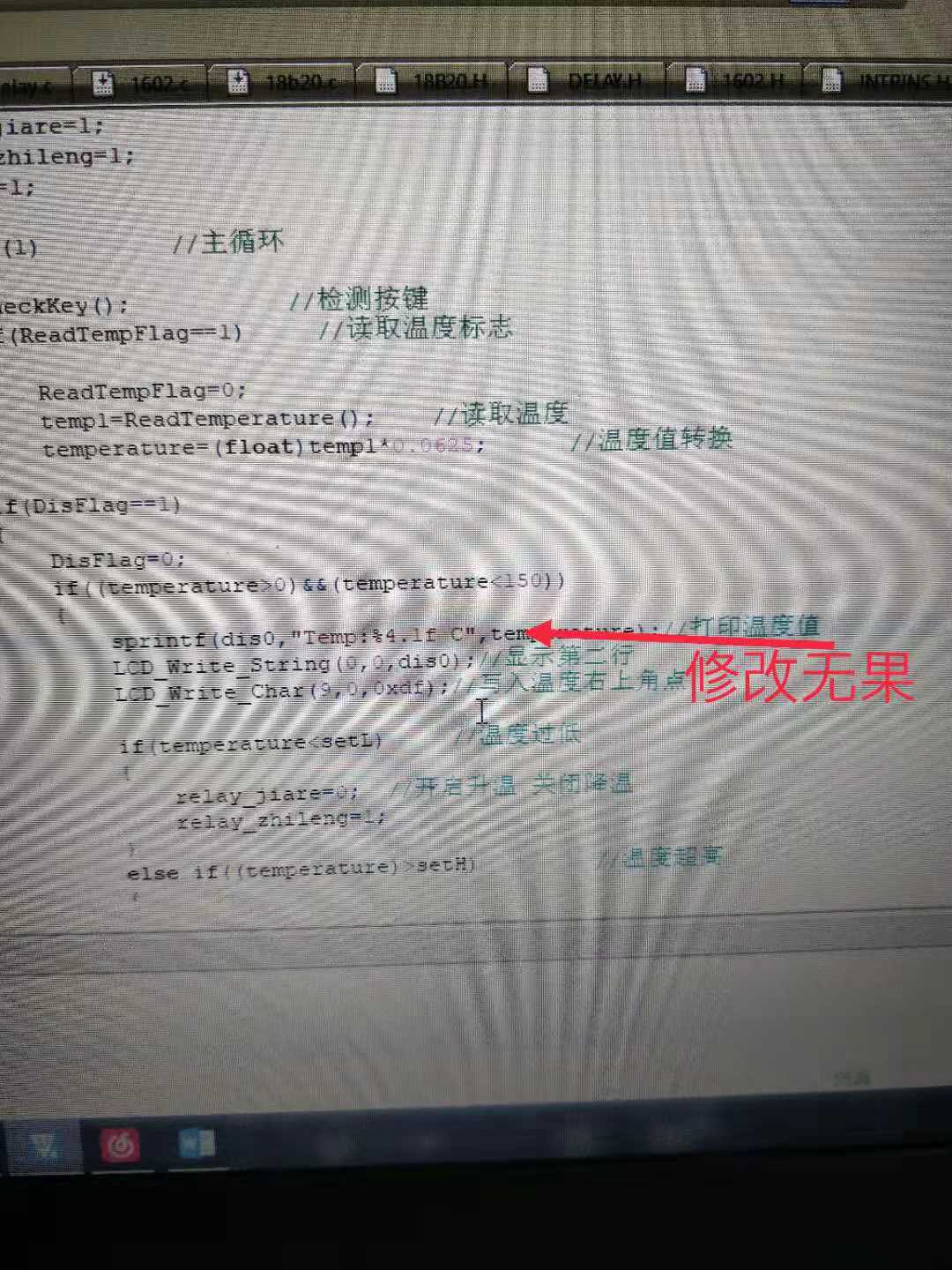

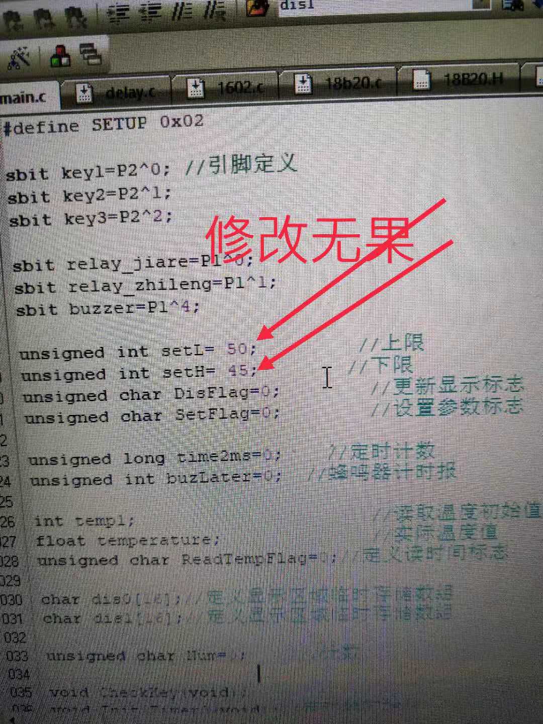

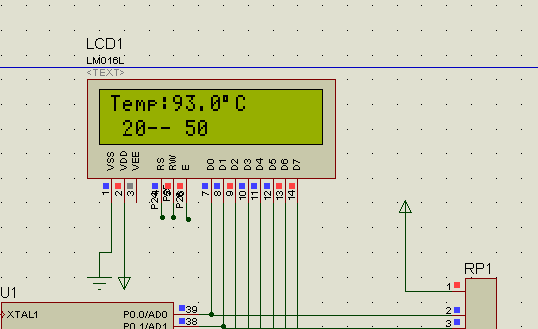

修改多次任然无果 找不出具体原因 属实头疼 望大神指点迷津
附有 仿真图 跟 源程序

- unsigned int setL= 50; //上限
- unsigned int setH= 45; //下限

- if((temperature>0)&&(temperature<150))
- sprintf(dis0,"Temp:%4.1f C",temperature);//打印温度值
- LCD_Write_String(0,0,dis0);//显示第二行
- LCD_Write_Char(9,0,0xdf);//写入温度右上角点
- if(temperature<setL) //温度过低
- relay_jiare=0; //开启升温 关闭降温
- relay_zhileng=1;
- else if((temperature)>setH) //温度超高
- relay_jiare=1; //关闭升温 开启降温
- relay_zhileng=0;
- else //正常温度
- relay_jiare=1; //关闭升温 关闭降温
- relay_zhileng=1;
- buzLater=0;
- if(buzLater>=60)//正常清零 否则过高过低都会累加 超过1min
- {buzzer=0;} //打开蜂鸣器
- else
- {buzzer=1;} //关闭蜂鸣器
- sprintf(dis1," %02d -- %02d ",setL,setH);
- LCD_Write_String(0,1,dis1); //初始化显示
