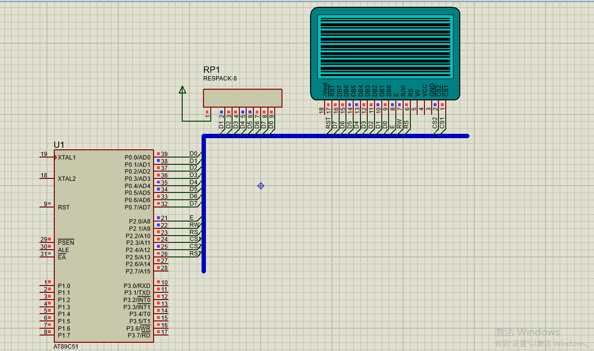

#include <reg51.h>
sbit E = P2^0;
sbit RW = P2^1;
sbit RS = P2^2;
sbit CS1 = P2^3;
sbit CS2 = P2^4;
sbit RST = P2^5;

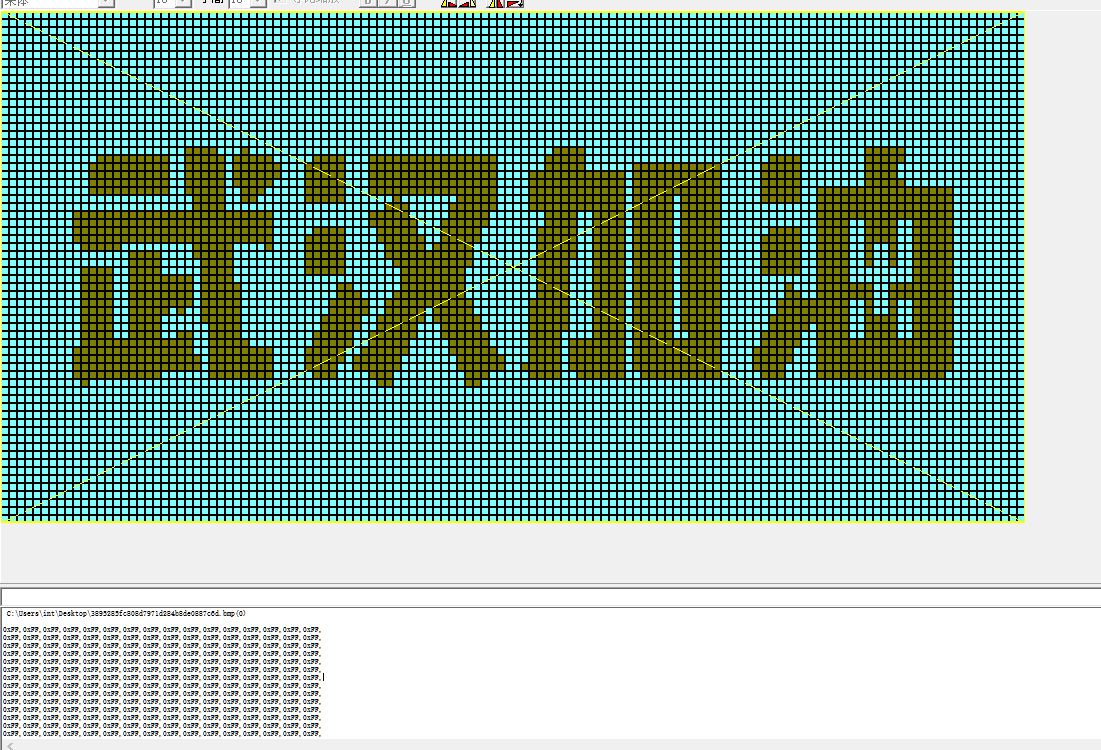

unsigned char code dis[] = {
0xFF,0xFF,0xFF,0xFF,0xFF,0xFF,0xFF,0xFF,0xFF,0xFF,0xFF,0xFF,0xFF,0xFF,0xFF,0xFF,
0xFF,0xFF,0xFF,0xFF,0xFF,0xFF,0xFF,0xFF,0xFF,0xFF,0xFF,0x87,0x83,0x83,0x83,0x83,
0x83,0x83,0x83,0x83,0x83,0xFF,0xFF,0x81,0x01,0x01,0x01,0x03,0xFF,0xC3,0x19,0x33,
0x93,0xC3,0xE7,0xFF,0xFF,0xFF,0x07,0x03,0x03,0x03,0x03,0xFF,0xFF,0xFF,0x83,0x83,
0x83,0x03,0x83,0x83,0x83,0x83,0x83,0x83,0x83,0x03,0x03,0x03,0x03,0x03,0xFF,0xFF,
0xFF,0xFF,0x0F,0x0F,0x03,0x01,0x01,0x01,0x01,0x0F,0x0F,0x0F,0x0F,0x0F,0xFF,0x07,
0x07,0x07,0x07,0x07,0x87,0x07,0x07,0x07,0x07,0x07,0xFF,0xFF,0xFF,0xFF,0xFF,0x07,
0x03,0x03,0x03,0x03,0xFF,0xFF,0x3F,0x3F,0x3F,0x3F,0x3F,0x3F,0x01,0x01,0x01,0x01,
0x19,0x3F,0x3F,0x3F,0x3F,0x3F,0x3F,0xFF,0xFF,0xFF,0xFF,0xFF,0xFF,0xFF,0xFF,0xFF,
0xFF,0xFF,0xFF,0xFF,0xFF,0xFF,0xFF,0xFF,0xFF,0xE1,0xC1,0xC1,0xC1,0xC1,0xC1,0xE1,
0x21,0x21,0x21,0x21,0xE1,0xE1,0xE1,0xE1,0x80,0x00,0x00,0x00,0x01,0xE1,0xE1,0xE1,
0xE1,0xC1,0xFF,0xFF,0xFF,0xFF,0x0F,0x07,0x07,0x07,0x07,0xFF,0xFF,0xFF,0xF9,0xE1,
0x80,0x00,0x00,0x03,0x0F,0x3F,0x1F,0x03,0x00,0x00,0x00,0xE0,0xF8,0xFE,0xFF,0xFF,
0xFF,0xFF,0xFE,0x06,0x00,0x00,0x00,0x80,0xFE,0xFE,0x00,0x00,0x00,0x00,0xFF,0x00,
0x00,0x00,0x00,0x00,0xFF,0x00,0x00,0x00,0x00,0x00,0xFF,0xFF,0xFF,0xFF,0xFF,0x0F,
0x07,0x07,0x07,0x07,0xFF,0xFF,0x00,0x00,0x00,0x00,0xFC,0xFC,0x00,0xE0,0xE0,0x00,
0xFC,0xFC,0x00,0x00,0x00,0x00,0x00,0xFF,0xFF,0xFF,0xFF,0xFF,0xFF,0xFF,0xFF,0xFF,
0xFF,0xFF,0xFF,0xFF,0xFF,0xFF,0xFF,0xFF,0xFF,0xFF,0x00,0x00,0x00,0x00,0xFF,0xFF,
0x00,0x00,0x00,0x00,0xC1,0xE1,0xC1,0xE1,0xFF,0x80,0x00,0x00,0x00,0x03,0xFF,0xFF,
0xFF,0xFF,0xFF,0xFF,0xFF,0xFF,0xFE,0xFE,0x3E,0x0E,0x02,0x03,0x07,0xCF,0xFF,0x3F,
0x0F,0x07,0x00,0x00,0x80,0xE0,0x80,0x00,0x00,0x00,0x0F,0x3F,0xFF,0xFF,0xFF,0xFF,
0xFF,0xFF,0x0F,0x00,0x00,0x00,0x00,0xFF,0xFF,0xFF,0x00,0x00,0x00,0x00,0xFF,0x00,
0x00,0x00,0x00,0x00,0xFF,0x00,0x00,0x00,0x00,0x00,0xFF,0xFF,0xFF,0xFF,0xFF,0xFE,
0x3E,0x0E,0x02,0x06,0x0F,0x8F,0x00,0x00,0x00,0x00,0xF3,0xF3,0x03,0x3F,0x3F,0x03,
0xF3,0xF3,0x00,0x00,0x00,0x00,0x00,0xFF,0xFF,0xFF,0xFF,0xFF,0xFF,0xFF,0xFF,0xFF,
0xFF,0xFF,0xFF,0xFF,0xFF,0xFF,0xFF,0xFF,0xFF,0xC3,0x80,0xC0,0xC0,0xC0,0xC1,0xC1,
0xC0,0xC0,0xC0,0xC0,0xE1,0xE1,0xE0,0xE0,0xE7,0xFF,0xC0,0xC0,0xC0,0xC0,0xC1,0xC3,
0xC3,0xC3,0xFF,0xFF,0xFF,0xFF,0xE3,0xC0,0xC0,0xC0,0xF0,0xFC,0xE7,0xE3,0xC0,0x80,
0x80,0xE0,0xF8,0xFE,0xFF,0xFF,0xFF,0xFE,0xF8,0xE0,0x80,0x80,0xC0,0xE3,0xE7,0xFF,
0xFF,0xEF,0xC0,0xC0,0xC0,0xC0,0xFF,0xE1,0xC1,0xC1,0xC0,0xC0,0xC0,0xC0,0xFF,0xE0,
0xC0,0xC0,0xC0,0xC0,0xC1,0xC1,0xC0,0xC0,0xC0,0xC0,0xFF,0xFF,0xFF,0xFF,0xE3,0xC0,
0xC0,0xC0,0xF0,0xFC,0xFF,0xFF,0xC0,0xC0,0xC0,0xC0,0xC1,0xC1,0xC0,0xC0,0xC0,0xC0,
0xC1,0xC1,0xC0,0xC0,0xC0,0xC0,0xE0,0xFF,0xFF,0xFF,0xFF,0xFF,0xFF,0xFF,0xFF,0xFF,
0xFF,0xFF,0xFF,0xFF,0xFF,0xFF,0xFF,0xFF,0xFF,0xFF,0xFF,0xFF,0xFF,0xFF,0xFF,0xFF};
void WriteCMD(unsigned char x)
int i;
RS = 0;//进入LCD命令状态
RW = 0;//写操作
P0 = x;//指令准备
E = 1;//数据读写操作允许位,允许指令写入
for(i = 0; i < 2000; i++);//一定反应时间
E = 0;//关闭允许
void WriteDATA(unsigned char x)
int i;
RS = 1;//进入LCD命令状态
RW = 0;//写操作
P0 = x;//数据内容准备
E = 0;//关闭允许
void LCDinit(void)
WriteCMD(0x3F);//开显示
WriteCMD(0xC0);//设置初始行
WriteCMD(0xB8);//设置X坐标
WriteCMD(0x40);//设置y坐标
main()
int x,y,k;
RST = 0;
RST = 1;
LCDinit();
for(k = 0,x = 0;x < 8; x++)//8bit,一个x是八行
CS1 = 0;
CS2 = 1;
WriteCMD(0xB8 + x);//设置X坐标
for(y = 0; y < 64; y++) WriteDATA(dis[k++]);
CS1 = 1;
CS2 = 0;
while(1);
