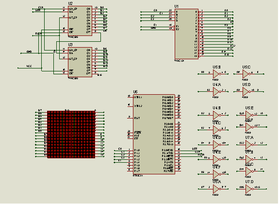

帮忙修改一下16点阵的代码,能显示几个字,最好能滚动
100黑币
电路图
电路图

#include<AT89X51.h>
#define uint unsigned int
#define uchar unsigned char
uchar code led[]=    { 0xBF,0xFF,  0xDE,0x7F,  0xC9,0x83,  0xDB,0xBB,
0xFB,0xBB,  0xFB,0xBB,  0x1B,0xBB,  0xDB,0xBB,
0xDA,0xBB,  0xD9,0xAB,  0xDB,0xB7,  0xDF,0xBF,
0xDF,0xBF,  0xAF,0xFF,  0x70,0x01,  0xFF,0xFF };
/********************延时程序 **********************/
void delay(uint x)
       uchar y,z;
       for(y=x;y>0;y--)
         for (z=250;z>0;z--);
/********显示屏扫描********************/
void ledplay()
     uchar i;
         for(i=0;i<16;i++)
             P1_4=1;
                 SBUF=led[i*2+1];
                 while(!TI);
                 TI=0;
                 SBUF=led[i*2];
                         while(!TI);
                                           TI=0;
                  P3_2=1;
                  P3_2=0;
                  P1=i;
                  P1_4=0;
                  delay(4);
/*******************主程序 ********************/
void main()
{SCON =0x00;
TI=0;
                   ledplay();
