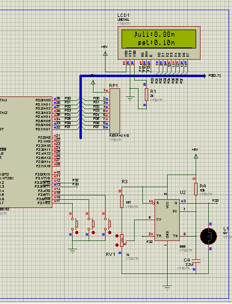

/*********************超声波测距程序*****************************/
void send_wave()
        c_send = 1;                           //10us的高电平触发
        delay();
        c_send = 0;
        TH0 = 0;                          //给定时器0清零
        TL0 = 0;
        TR0 = 0;                                  //关定时器0定时
        while(!c_recive);                  //当c_recive为零时等待
        TR0=1;
        while(c_recive)                      //当c_recive为1计数并等待
                flag_time0 = TH0 * 256 + TL0;
                if((flag_time0 > 40000))      //当超声波超过测量范围时,显示3个888
                        TR0 = 0;
                        flag_csb_juli = 2;
                        distance = 888;
                        break ;
                else
                        flag_csb_juli = 1;
        if(flag_csb_juli == 1)
                TR0=0;                                                         //关定时器0定时
                distance = flag_time0;
                distance *= 0.017;               // 0.017 = 340M / 2 = 170M = 0.017M 算出来是米
                if(distance > 600)                                 //距离 = 速度 * 时间
                        distance = 888;                                 //如果大于3.8m就超出超声波的量程
以上我的测距程序,不知道哪里错了,老超量程,求指导
